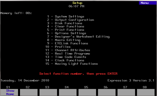

    The software version (main operating code) can be found by hitting the [Setup] key. The version number is located in the lower right hand corner of the monitor screen.
    Expression Setup Screen
    Note: As the console boots up you will see the version of boot code that the console has. Do not confuse this with the main operating code!
