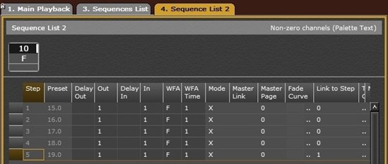

    Above is an example of a looping Chase Sequence. Each preset is set to automatically follow another, and on the final Step it loops back to Step 1.
    Looping Chase Sequence

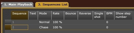

    Pressing the [SEQ] key brings up the Sequence List, where the Sequence can be set to Chase Mode.
    Chase Mode

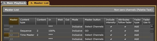

    Here I've assigned two Masters. The first I assigned by pressing # [SEQ]&[Master Key #11]. The second one I assigned in the Master List, which can be found either in the Browser or by pressing [MODIFY]&[MASTER]. The Content # of the Time Master corresponds with the Sequence # being affected. Wherever this Sequence is playing in the console, it will be affected, including the Main Playback.
    When the Chase Sequence is active and I bring up Master #11 (which controls intensity), it will remain paused until Master #12 is also brought up. Bringing the level of Master #12 up above 0% will allow the Sequence to start.
