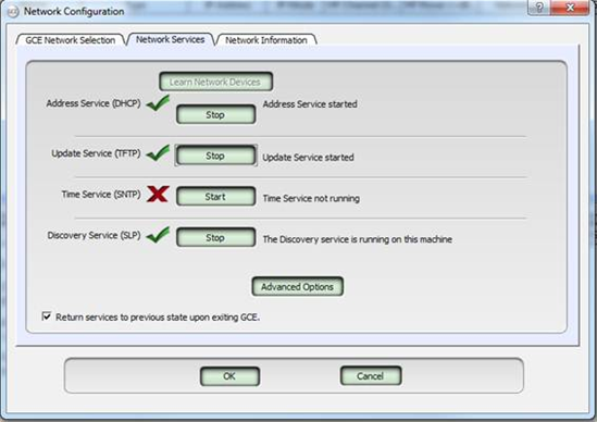

    Step 1: Launch GCE and make sure that Address Service and Update Service are both enabled.

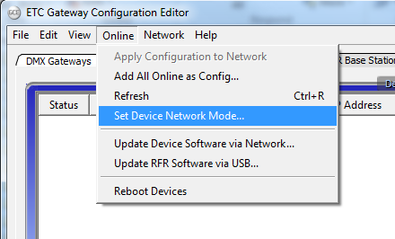

    Step 2: With your 1-Port Gateways connected, go to the Online menu and select "Set Device Network Mode"

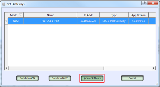

     Step 3: In the following dialog, select the 1-Port Gateways that you wish to update (in this example it is named "Pre-GCE 1-Port") and choose {Update Software}.

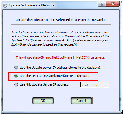

     Step 4: Be sure to direct GCE to use your computer as the source for the update.
