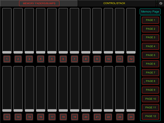

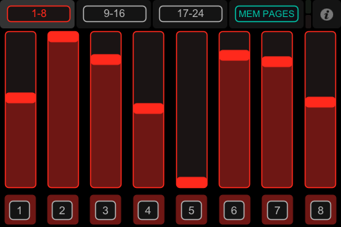

    These two TouchOSC layouts were created by ETC SmartFade user Richard Howey:
    iPhone/iPod Screenshots:
    iPhone, iPod, iPad Touch OSC
    iPad
    iPad
