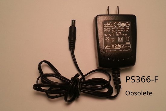

    A previous non-locking version of the power supply was the PS366-F. However, that part is no longer available.
    PS366-F
