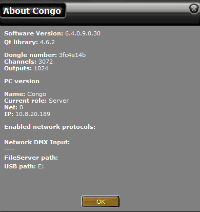

    • 1. Check your current channel count by navigating to Browser>About>About Congo.
             Full About Menu About Congo Menu Tree About Congo Window

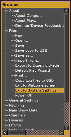

    • 2. Next, choose Exit to System Settings from Browser>Files.

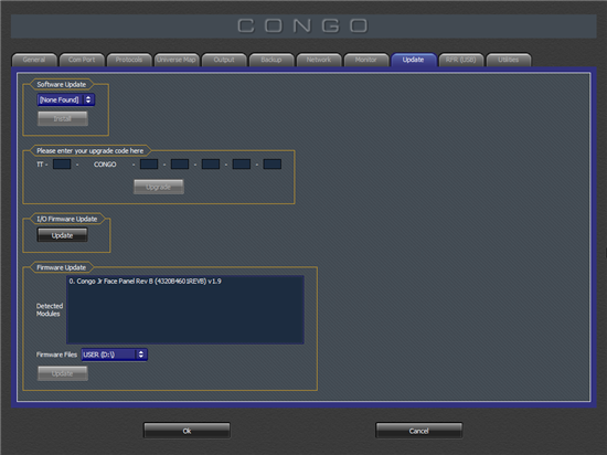

    • 3. Choose the Update tab from the System Settings Menu.
          Update Tab

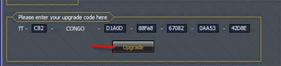

    • 4. Enter your upgrade code in the space provided. Please note that the "TT" and "CONGO" portions do not need to be entered.
        Entering Upgrade Code

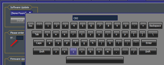

    Each segment will pop up a keyboard image.  You can enter the text on the screen with a mouse, or using a USB keyboard.  Press enter when segment is added.  Then select and begin adding the next segment.
        Upgrade Code
    • 5. When full code is entered, select {Upgrade}.
      Click Upgrade

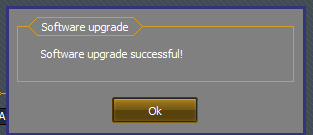

    • 6. Choose {OK}
      Choose OK

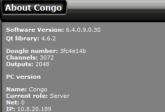

    • 8. Verify you channel output by navigating to Browser>About>About Congo.
      About Congo
