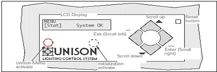

    For a CME, CMEi or CMEd:
        1) Press and hold the hidden "Unison Menu" button just above the Unison symbol in the lower left corner
            of the processor screen, Until the "Menu Stat" appears.
                  Unison Menu
        2) Press the down arrow until the screen displays "ARCH" and press [Enter].
    The processor will now display the Architectural Software version after the word ARCH
    Please make certain that your Light Manger software version matches that of your processor.  If it does not, stop and call ETC Tech Services.
