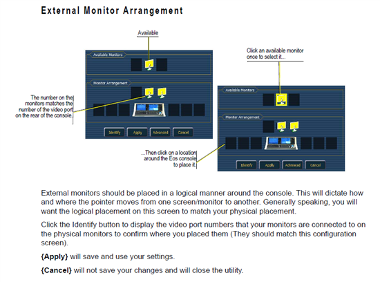

    • The configuration of the external monitors is done in the EOS Configuration Utility (the ECU, otherwise known as the Shell)
      • To access the shell, press the Displays key, and select {Exit Eos} from the menu
      • Press {Ok}
      • After a few seconds, the {Settings} button will light up in yellow. Click on it, and go to the General tab
      • Select {External Monitor Arrangement}
    • In the ECU it is possible to configure the logical monitor placement to match the physical monitors
    External Monitor Arrangment
