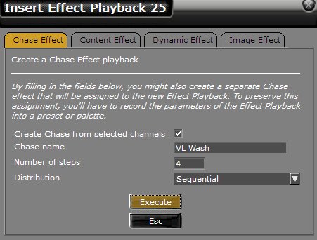

    2.  Type [#] [INSERT]&[EFFECT], opening the following dialog box:
    Insert Effect Playback 25
    3.  Select "Create Chase from selected channels".
    4.    Give your effect a name.
    5.  Select the distribution.
    6.  Select Execute.

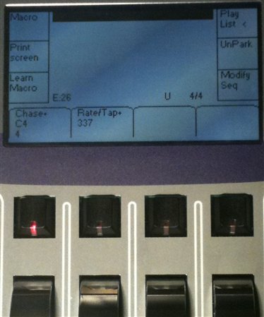

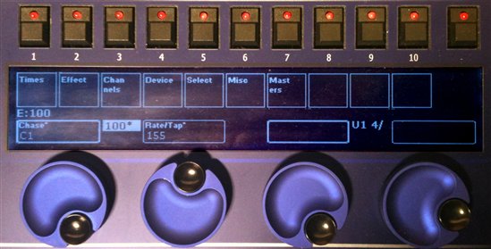

    Step #7 on Congo:
     Step 7 on Congo
    Step #7 on Congo Jr (Clicking the encoder wheel allows Tap control of the rate.):
     Step 7 on Congo Jr
