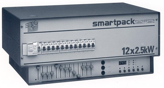

    SmartPacks (Touring Version) and SmartRacks (Wallmount/Installation version) were a product of Arri Lighting Ltd (UK) which were for a while sold under the ETC label when ETC purchased Arri Lighting. They are a 230V 50Hz (CE, European) product only.
    There were several product variants, including 3kW and 5kW types.
    SmartRack 2
    SmartRack
    User Interface
    The user interface consists of three red seven segment displays. The portable packs featured faders for manual override of control; the wall mount packs typically do not.
    The user interface 'locks' to prevent unauthorised access. To unlock press and hold the enter key for three seconds. To re-lock, press the enter key when the LED next to it is on but not flashing.
    Once unlocked you can set the DMX address using the up and down arrow keys.
