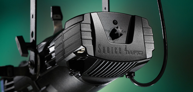

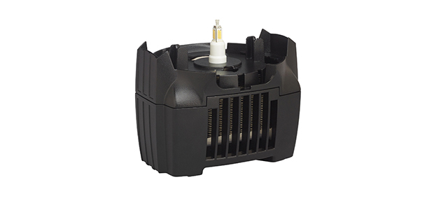

With every product ETC manufactures, we strive to stay at the forefront of technology while holding quality to the highest standard. As with any new technology, things don't always go as planned. Source 4WRD™ incorporates an advanced heat pipe cooling system that was custom designed and built for ETC by an expert in the field. We've been monitoring long-term life-cycle testing for months and recently discovered that this heat pipe may experience premature degradation of its heat-transport mechanism under certain conditions. This increases heat at the LED array and reduces the usable life of the product.
This problem may not occur for a very long period of time, if ever, under normal use. The degradation does not cause any safety issues, but is the reason we proactively placed Source 4WRD on a shipping hold several weeks ago. It is safe to continue using all Source 4WRD fixtures existing in the field. We are working to qualify new parts from our vendor and have high hopes that we are on the road to fixing the heat pipe issue soon.
